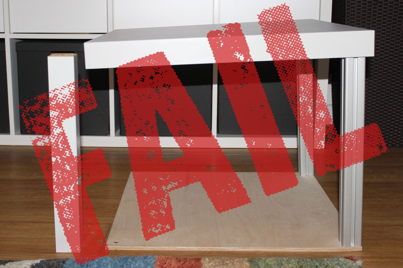

As you can see in the picture, I tried using a 10 mm ply board plate, but due to the weight of the aluminum profile it started to bend. So I decided to use steel plates which worked really well.
