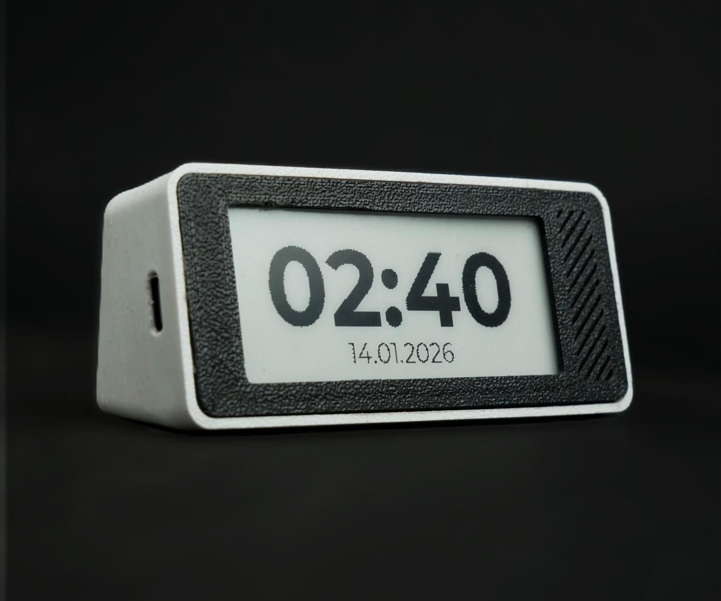

Introduction: Tiny Internet Clock
In this project, we will build a tiny internet clock connected to your wifi to get time from NTP servers.

Step 4: Wiring Diagram
This is the wiring diagram
Step 5: Assembly and Wiring
Step 1
Connect all 4 wires between OLED and Xiao
Step 2
Glue the oled into the font panel
Step 3
Stick the antenna on the top of the 3d print
Step 4
Place the xiao into the 3d print make sure the USB port is visible on the back glue it with a glue gun. Also, connect the antenna to the board
Step 5
Close the front cover by glueing it
Step 6: Test
Please connect the USB cable to power the device, which will automatically update the time.
