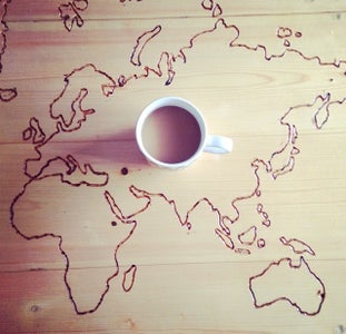

Step 5: The Design AKA the Fun Part
This is where this project gets really fun. Once you have your table top assembled and sanded fairly smooth ( I sanded with 80 grit followed by 120) it's time to start engraving. In order to transfer my design to the table I glued my map right to the wood with spray adhesive. Gluing the map right to the wood saves time, but it leaves a sticky residue which takes time to sand off. The alternative method is to use transfer paper. To do this you tape the transfer paper to the wood and then the the map on top. Once everything is taped down you have to trace over each line of the map that you want to engrave. This method takes a bit longer to get the design on the wood but saves time in sanding.
Step 6: Engraving
Once the design is on the wood you can start engraving. Before actually engraving on the wood I recommend trying out the Dremel and engraving bits on some scrap wood because they can be tricky to get the hang of. When I was starting this project I looked up a few different engraving techniques on youtube, but that's about as far as my experience with the tool goes, which just goes to show that this project can be done by any beginner.
The first pass of engraving I used the smallest spherical engraving bit. By pushing down lightly, just hard enough to cut through the paper and slightly scar the wood, you're able to keep control of of the Dremel and stop it from jumping where you don't want it. After the first pass I tore off the paper so it wasn't in my way. I then did another pass with this small bit, followed by a pass with a medium spherical bit, and finally a pass with a large spherical bit. With each pass I deepened the engraving so that when I sanded the top there was no risk of erasing the design. If you have a different set of engraving bits you may have different sized bits than I did, but that shouldn't matter in the long run.
After using each of the bits you should have your map sitting gloriously in front of you, showing the world in all its splendor. If you glued your map right to the wood your map may be covered in black sticky gunk, but that's ok, you'll just have to do some serious sanding to get rid of it.

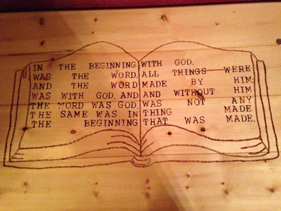

Step 17: Book Coffee Table
And finally here's an open book coffee table design. I was asked to make this table with this specific verse, but the design could easily be adapted to your favorite book quote! To make the letters I used a letter burning attachment for the wood burning tool, which can also be conveniently bought on Amazon! For the book design I just googled open book picture and there it was. The internet really is pretty neat!
