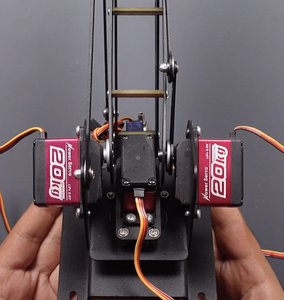

The board was able to move eleven hobby servo motors simultaneously. Let's try moving a robotic arm in the next step.
#include <Servo.h> static const int servo1Pin = 13; static const int servo2Pin = 16; static const int servo3Pin = 27; #define LEDpin 23 Servo servo1; Servo servo2; Servo servo3; void setup() { Serial.begin(115200); servo1.attach(servo1Pin); servo2.attach(servo2Pin); servo3.attach(servo3Pin); pinMode(LEDpin, OUTPUT); delay(3000); } void loop() { for(int posDegrees = 90; posDegrees <= 120; posDegrees++) { servo1.write(posDegrees); digitalWrite(LEDpin, HIGH); Serial.println(posDegrees); delay(20); } delay(100); for(int posDegrees = 120; posDegrees >= 90; posDegrees--) { servo1.write(posDegrees); Serial.println(posDegrees); digitalWrite(LEDpin, LOW); delay(20); } delay(100); for(int posDegrees = 90; posDegrees >= 60; posDegrees--) { servo1.write(posDegrees); Serial.println(posDegrees); digitalWrite(LEDpin, HIGH); delay(20); } delay(100); for(int posDegrees = 60; posDegrees <= 90; posDegrees++) { servo1.write(posDegrees); Serial.println(posDegrees); digitalWrite(LEDpin, LOW); delay(20); } delay(100); for(int posDegrees = 100; posDegrees <= 150; posDegrees++) { servo2.write(posDegrees); digitalWrite(LEDpin, HIGH); Serial.println(posDegrees); delay(20); } delay(100); for(int posDegrees = 150; posDegrees >= 100; posDegrees--) { servo2.write(posDegrees); digitalWrite(LEDpin, LOW); Serial.println(posDegrees); delay(20); } delay(100); for(int posDegrees = 80; posDegrees <= 130; posDegrees++) { servo3.write(posDegrees); digitalWrite(LEDpin, HIGH); Serial.println(posDegrees); delay(20); } delay(100); for(int posDegrees = 130; posDegrees >= 80; posDegrees--) { servo3.write(posDegrees); digitalWrite(LEDpin, LOW); Serial.println(posDegrees); delay(20); } delay(2000); }
In this code, we will again provide self-move. Let's move the servo motors at the specified angles using the "for loop". This time I will supply the 6.6 volts needed by the robotic arm motors to the board. The board has successfully moved the high-torque robotic arm servo motors... In the next section, we will move it wirelessly using an app via bluetooth.

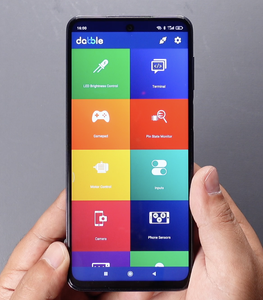

In this section we will use a smartphone application. I needed a smartphone application to wirelessly control motors via bluetooth, and I discovered an application. This is an application developed by STEMpedia that you can use for free on Android and iOS devices.
In this project I chose the digital mode, this way I have a hand controller with many buttons to move the robotic arm in many directions. The digital mode is the default mode when the gamepad is turned on. Let's move the servo motors at the defined angle when the buttons in the gamepad mode are pressed.
Using Gamepad module with ESP32:

When any gamepad button is pressed, the function you want is executed. The board successfully established bluetooth and smartphone communication... In the next and last section, let's communicate by providing one-way communication between two ESP32 boards.
