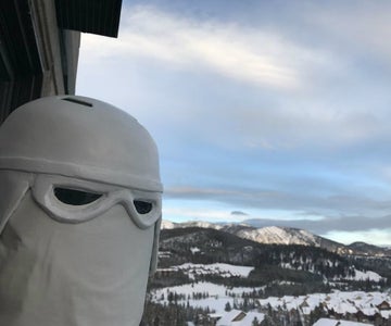

Every year my family goes on a ski trip and there are always people wearing good (and bad!) costumes. I've always wanted to make something that not only would look cool but wouldn't hinder movement. So when the new Star Wars came out I realized I could make something from Star Wars; and what better helmet to make for a snow sport than a snowtrooper!

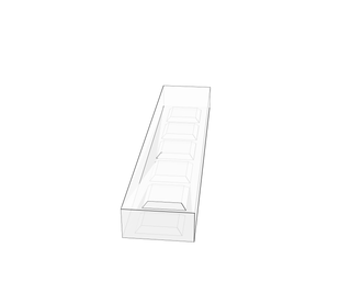

The first step is to 3D print the back indents (.stl provided). Once the file is printed get some medium grit sand paper and sand the whole piece.

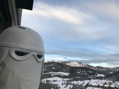

Step 13: Wear It!
