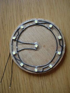

Surface mount Light Emitting Diodes(SM LED's) were a great find on the internet. you can get them from store like Maplin or Rapid for as little as £0.11 a light! because they are so small they don't make the thickness of the Arc reactor much thicker. this helps keep it as small as possible. The SMLED's are very powerful. using the information of Rapid electronics i calculated how much current and voltage i needed for all eleven SMLED's.to save you working this out here it is: A nine volt Battery with 5 x 180ohm resistors and 1 x 330ohm resistor.
the resistors and the SMLED's come in a large enough casing for you to solder them by eye. but i recommend buying a solder with detachable heads so that you can also purchase a fine tip soldering head. This will allow you to be more accurate and look a lot neater than mine looks!
Before soldering the parts toghether mark out where each resistor and SMLED will go. to do this dived 360 by 10 as this is how many you need on the outside. this will give you 36. using a protractor mark every 36° with a line. and fine the center of the material. now using a small amount of super glue, glue all of the components down. for the first attempt i used a thin piece of wood but even this was to thick and when using a solder it burnt the wood a bit. so for the second attempt I used some thin acrylic plastic which was lighter and the glue set a lot better.
Once all of the components are glued down you can now measure how much wire you need between each one. cut all of the wire out and lay it down without soldering it just to check. after you give yourself the all clear begin to solder all of the wires to the components. remember to leave a long bit of wire sticking out so you can later attach the battery pack and switch.
