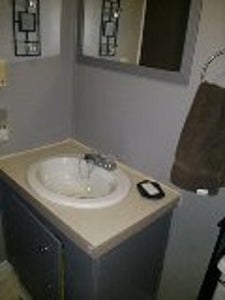

I've attached a 'before' pic of what my bathroom counter used to look like before I began my project of dressing up my countertop
there's really nothing wrong with it ..I just want to make it look better

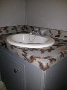

Next I dab..starting with my darkest colours...all my different colours of paint
At this point I'm always somewhat apprehensive since it's super ugly
I'm using a real sponge since they look more natural
you can see from the pics that I am doing different colours and letting them dry in between

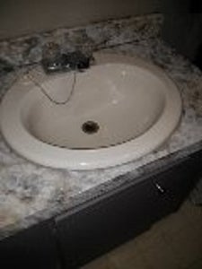

once you're happy with the end result
next step is to put your clear coat finish on it to seal it

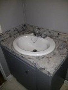

In total I put four coats of clear on the countertop
after the clear coat is totally dry remove your green painters tape
I've included a 'before' and 'after' pic so you can see the difference..I'm quite pleased with the 'new look'
and am enjoying my new DIY faux granite look
