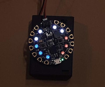

Step 9: Have Fun Playing With the LED Color Lights
You have probably noticed that clicking on the various color buttons (R, O, Y...) causes an N command to be invoked. So, the "R (red)" button invokes the command line: "0 49 500 N". The syntax for this command is "startLED stopLED color N". But there are only 10 LEDs on the Circuit Playground Bluefruit, so why the 49? That's because this web page was designed to work with other Adafruit bluetooth devices and can support a strand of up to 50 LEDs (0 to 49). For the Circuit Playground Bluefruit, you could have used the command "0 9 500 N" and it would have worked just fine.
The color number (500 for the R button) is a 3 digit number where each digit (0 to 9) represents the relative amount of Red, Green, and Blue to mix in creating the LED colors.
Here are some color number recipes for various colors but you should feel free to mix your own color combinations:
  • 700 Red
  • 710 Orange
  • 730 Yellow
  • 070 Green
  • 055 Cyan
  • 007 Blue
  • 405 Violet
  • 723 Pink
  • 555 White
It's also not necessary for all the LEDs to be the same color. The following command line will create a pattern of Red, White, and Blue where the first LEDs (0,1,2) will be red, the next 4 LEDs (3,4,5,6) will be white, and the last three LEDs (7,8,9) will be blue:
0 2 700 N 3 6 555 N 7 9 007 N
