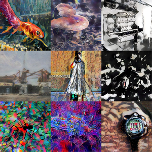

In the previous comment to art, images were only stored locally on the Raspberry Pi and previewed for a short amount of time on Remo.TV. This means you couldn't look back at all the previous works of art, which is a shame, as there are a lot of cool pictures worth sharing.
