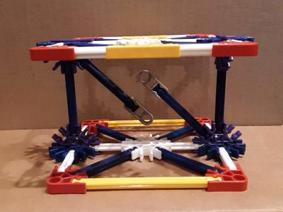

Step 3: Assemble the Two Pieces Together
Just a reminder, the two side blue rods that connect the top and bottom pieces will eventually be removed. They are temporarily providing a rigid structure for the assembly to make it easy for the string to be attached.

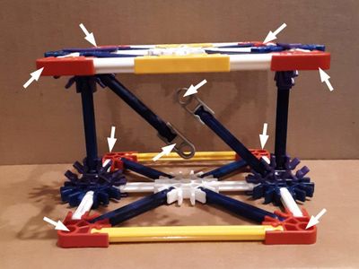

Step 4: Add String to the Model
Add string to the model in the positions shown by the arrows. Be particularly careful to note which holes are being used in the two pieces in the center of the model. You may find it helpful to use a slip knot to tie the string and double-knot it after you get the tension right. After stringing the model together, you can remove the two blue rods supporting the top and bottom pieces.
Step 5: Congratulations! You're Done
That completes this project. I also wanted to share a modified version of this build that I designed. Thanks much for viewing this instructable. Please let me know if you build it and any additional ideas or suggestions you may have.
