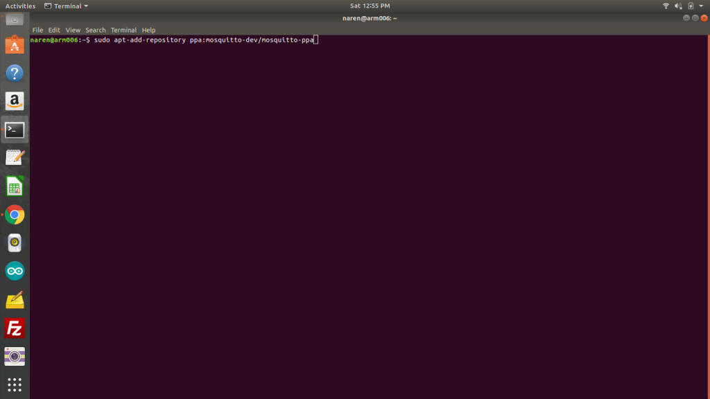

We will be showing you on how to install Mosquitto on a Linux based system (Ubuntu 18.04). To do this first add Mosquitto to the ubuntu source list. Once Mosquitto is available in the Ubuntu repositories you will be able to install it with apt-get.

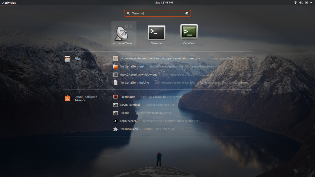

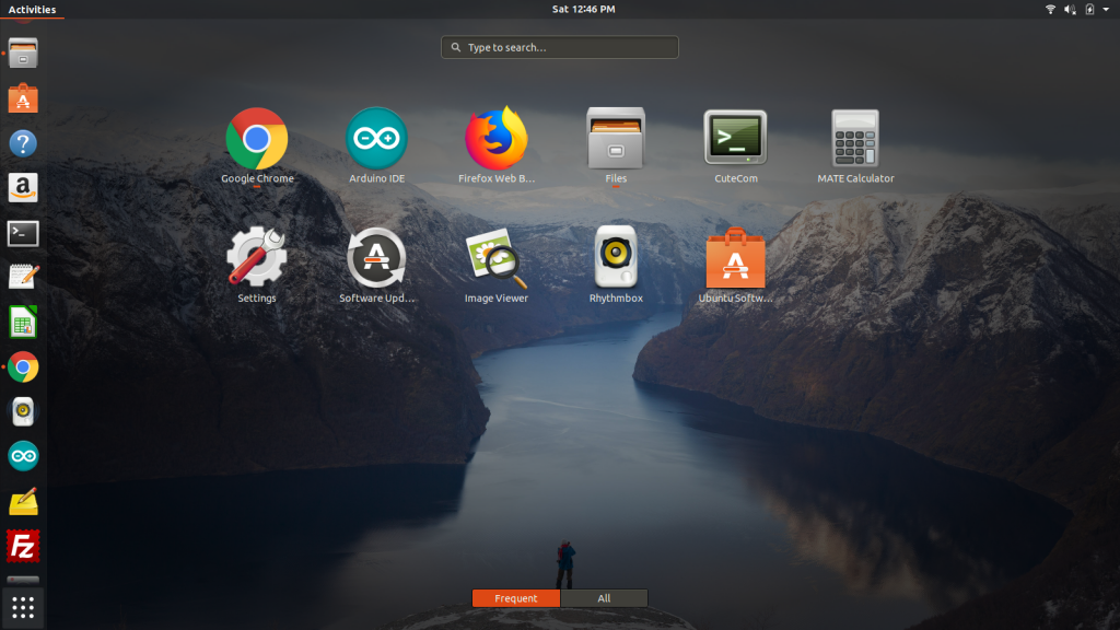

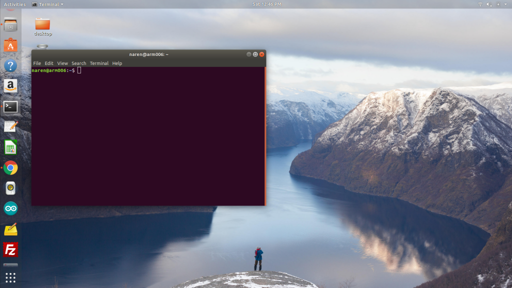

Just open a Terminal. To open a Terminal, go to Left hand bottom corner of Ubuntu Desktop, Click on Show application (Doted 3X3 grid). A Window will open. There you search for Terminal. Click on terminal you should be able to see a window open as show in the following images.
Enter the following commands after you open the Terminal

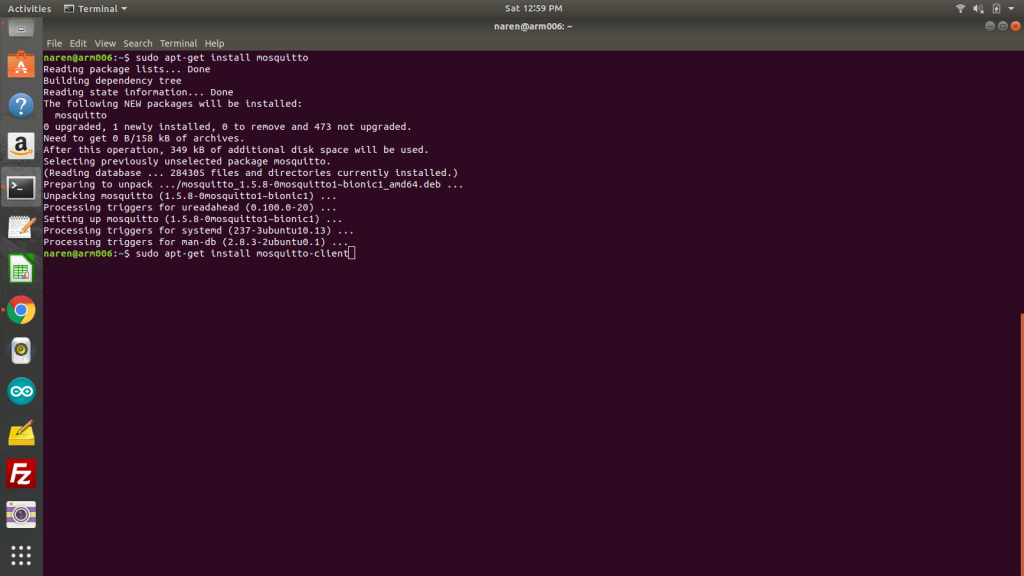

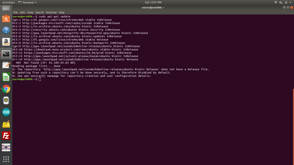

sudo apt-add-repository ppa:mosquitto-dev/mosquitto-ppa
sudo apt-get update<strong> </strong>
sudo apt-get install mosquitto

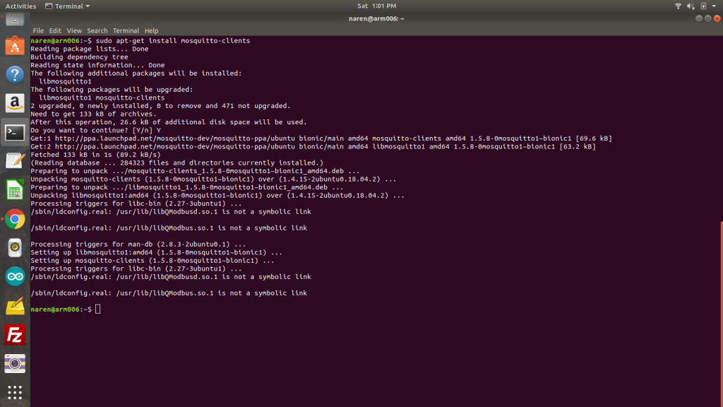

You can also install the Mqtt client. Command to do that will be
sudo apt-get install mosquitto-clients

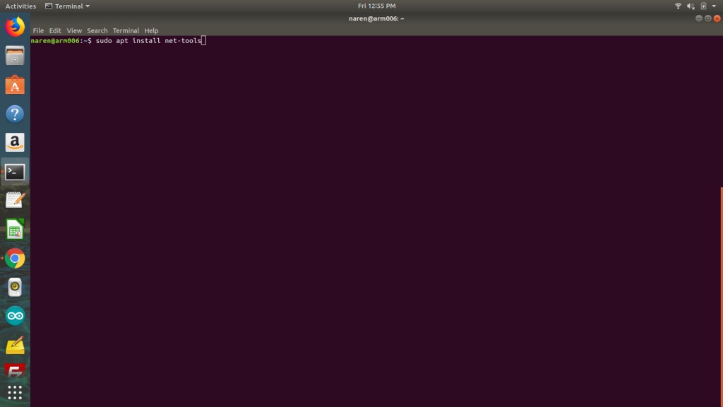

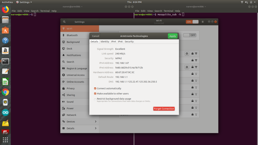

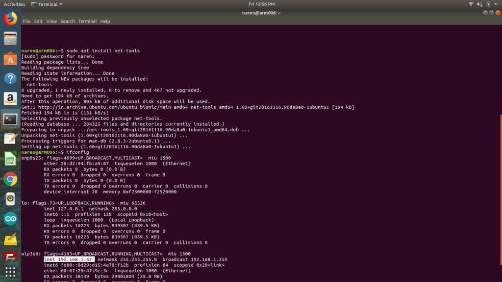

Or to find IP address of broker you can find IP address by installing net tools using the following command in the terminal
sudo apt install net-tools
Installing net-tools (Image 9). After that just type the command ipconfig you will get a list of network interface with the mac and IP address
sudo ipconfig
IP address of my system is 192.168.1.67 (Image 10)

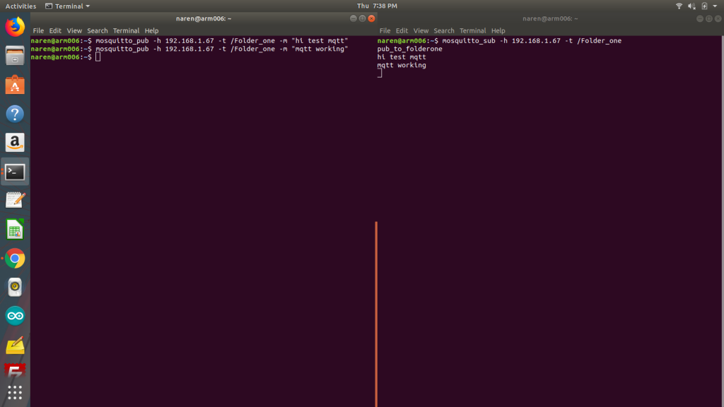

Example for publishing
mosquitto_pub -h 192.168.1.67 -t /Folder_one -m “hi test mqtt”
mosquitto_pub -h 192.168.1.67 -t /Folder_one -m “mqtt working”
Example for response received on subscribing to topic
mosquitto_sub -h 192.168.1.67 -t /Folder_one
Message sent by the publisher:
- pub_to_folderone
- hi test mqtt
- mqtt working
Pub Sub in two separate terminal window side by side (Image 11)

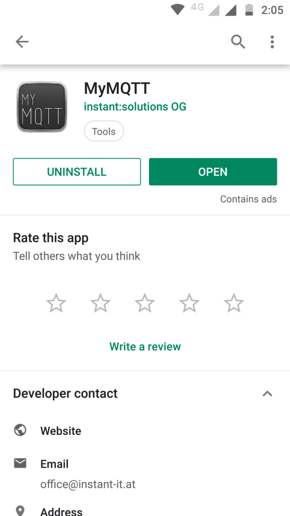

Install mymqtt app from play store on your android phone (Image 12)

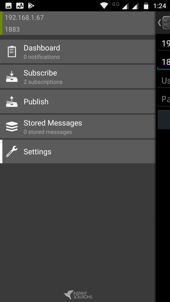

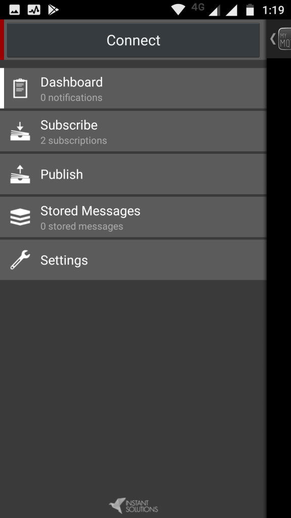

Open the app and click on the left hand top corner (Image 13, Image 14).

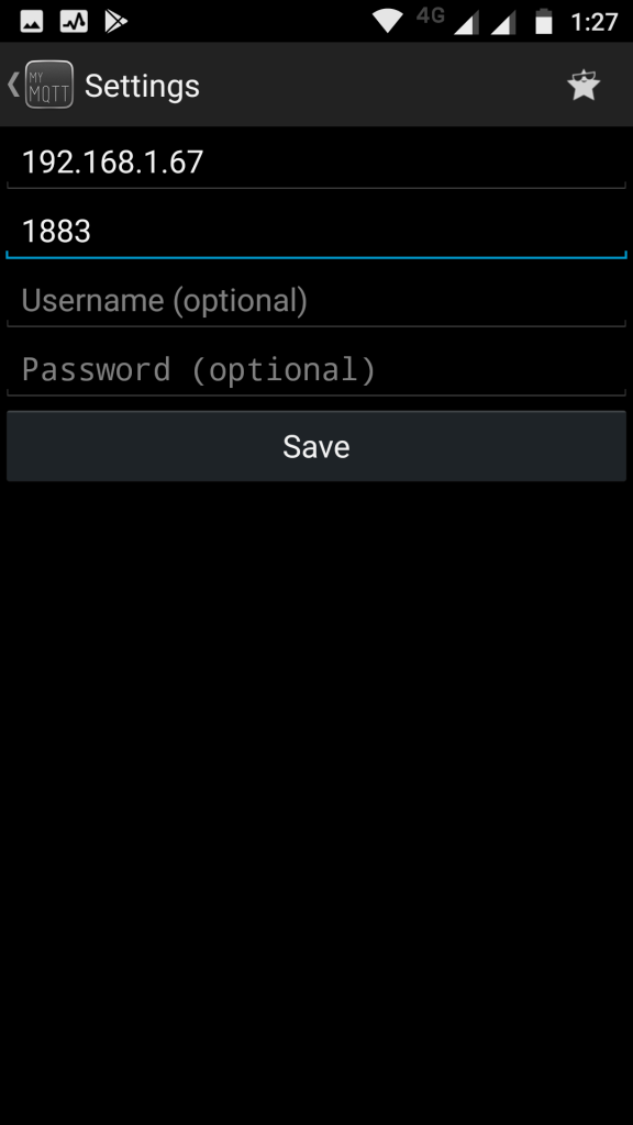

Click on Settings and enter the broker IP address, port by default will be 1883. Currently we are not using authenticated mqtt broker so the user name and password will be blank. Just save it and again click on the left top corner of the app (< Settings) the drawer will reopen (Image 15).
On the top of the drawer it will show you the broker IP address and port the app is connected to (Image 16).

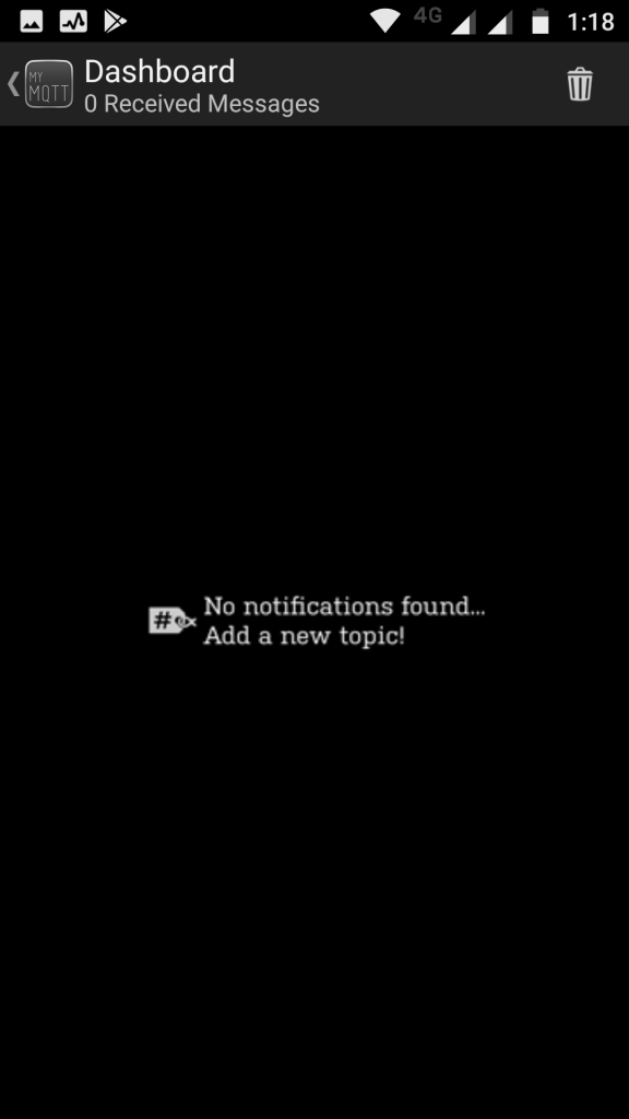

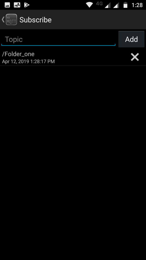

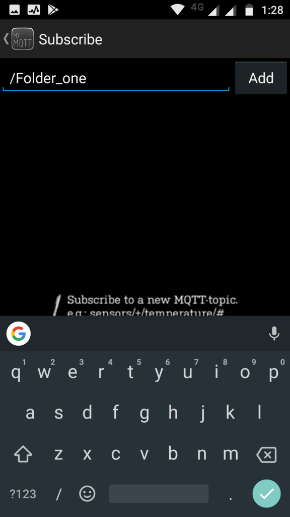

Now add the topic you wish to subscribe by clicking on Subscribe . Here we will be adding topic as /Folder_one (Image 17, Image 18).

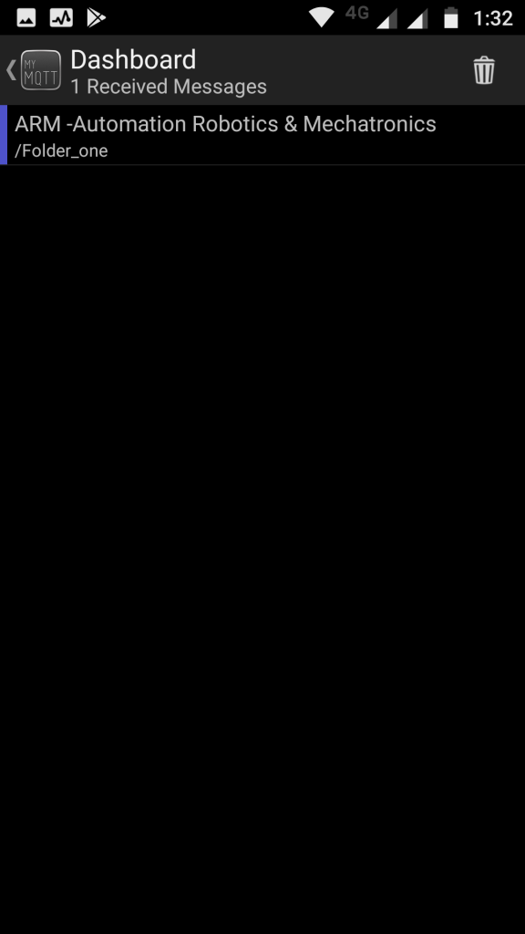

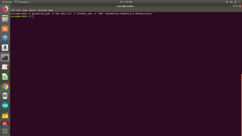

After doing this, from the ubuntu system by using terminal we will publish to the topic. On publishing you should get the payload/message published on this mobile app. For example publishing payload as “ARM -Automation Robotics & Mechatronics ”. Command is as mentioned earlier.
mosquitto_pub -h 192.168.1.67 -t /Folder_one -m “ARM -Automation Robotics & Mechatronics ”
publishing from ubuntu system (Image 19).
Received published message on dashboard (Image 20).

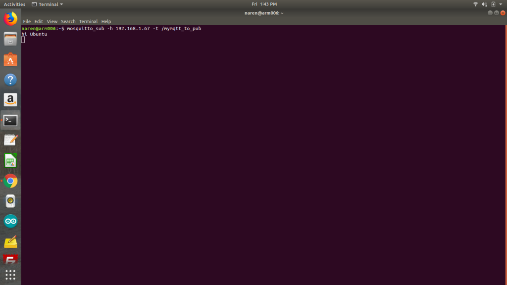

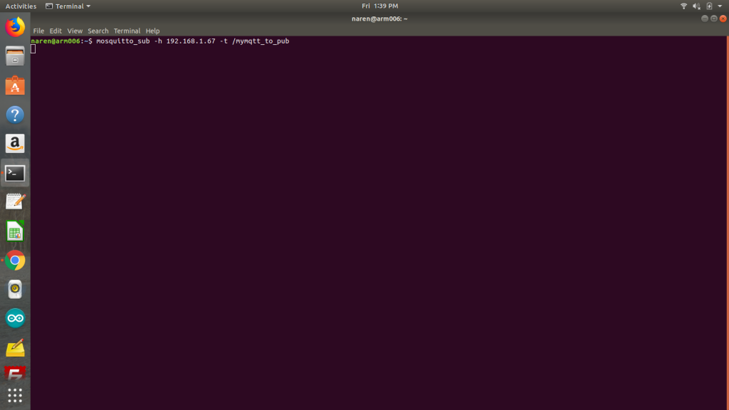

Now let us publish from android phone (My mqtt) and subscribe on ubuntu system. For this example we are using the topic “/mymqtt_to_pub”.
To do this first open a terminal from your ubuntu system and subscribe to the topic “/mymqtt_to_pub” using the following command (Image 21)
mosquitto_sub -h 192.168.1.67 -t /mymqtt_to_pub

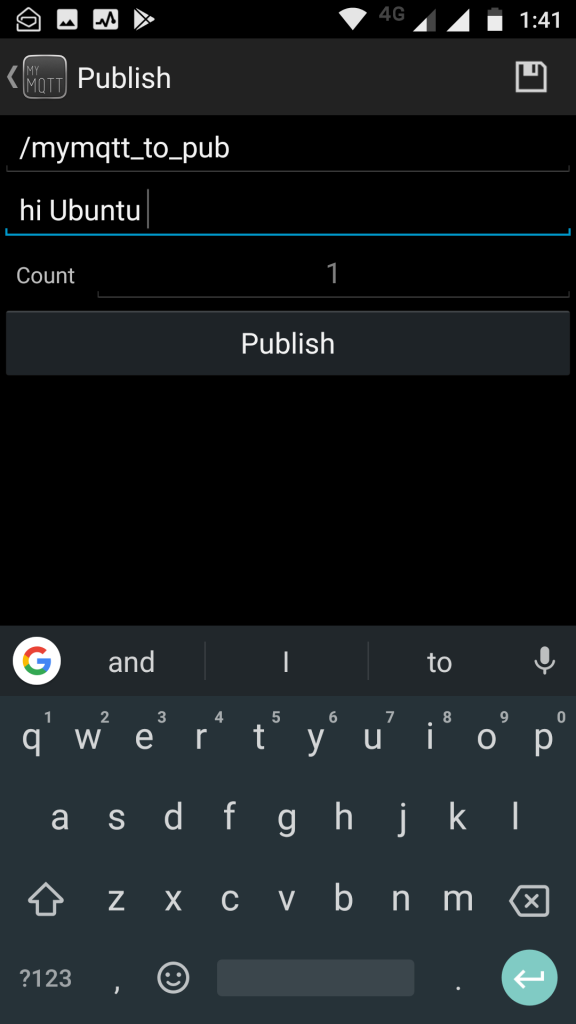

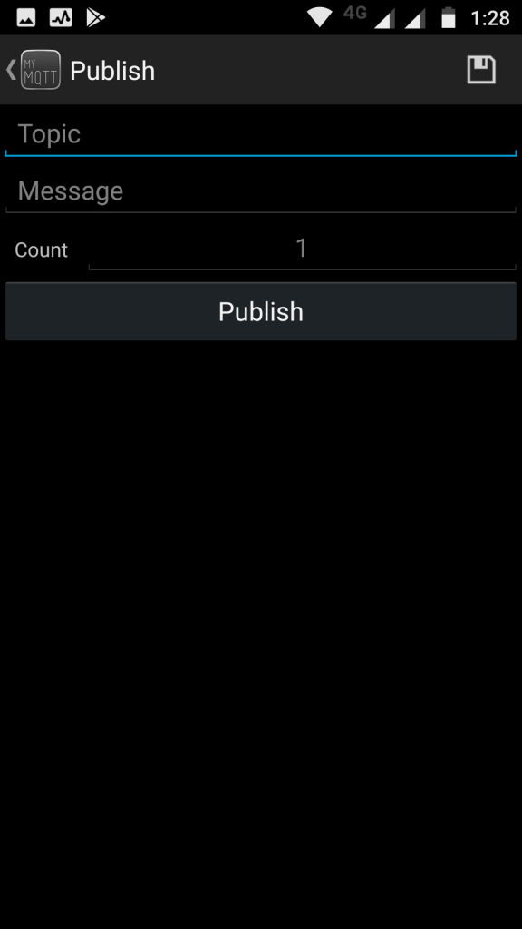

Now go to the drawer of the mymqtt app and click on publish. Add the publishing topic (In our case it is “/mymqtt_to_pub”) and send some message like we will send “hi Ubuntu”, press the send button (Image 22, Image 23).
The message should appear on your terminal window of ubuntu system (Image 24).

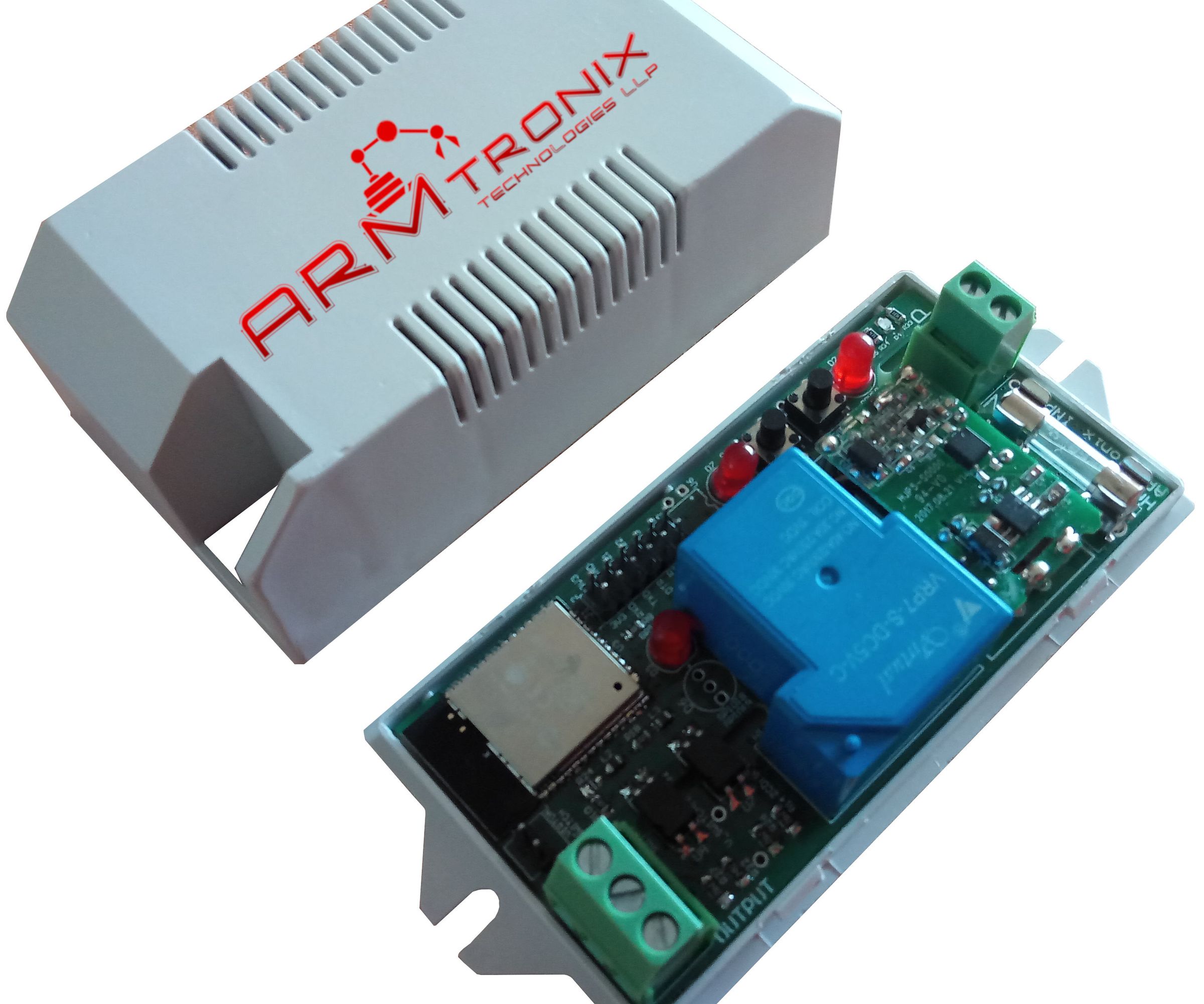

Currently for this instructable, we are using our Wifi Single Dimmer Board which uses Triac to chop the sine wave and in turn dims bulb or control the speed of the fan. Also we have connected it through mqtt authentication type.

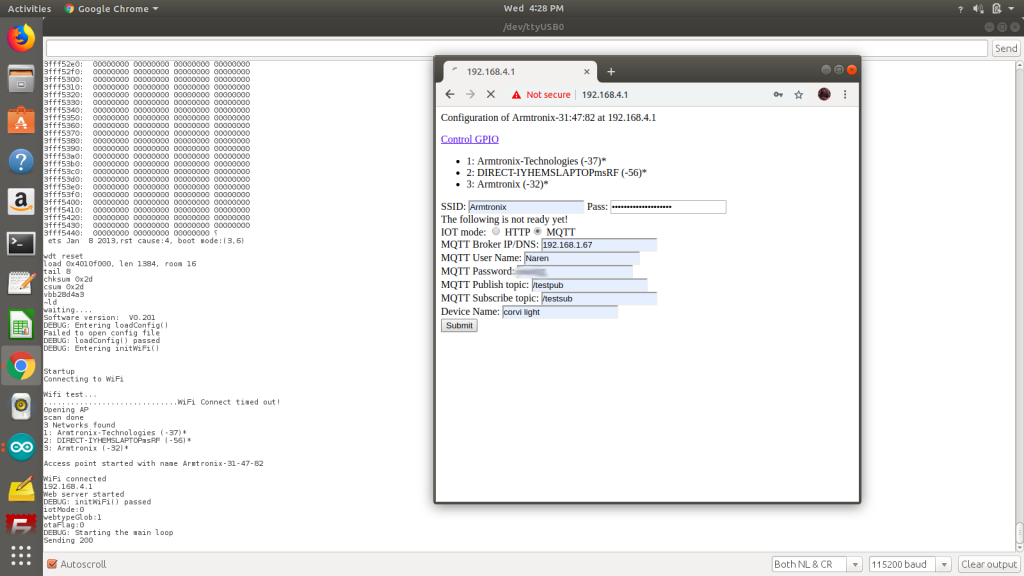

Initially we have configured the board. Steps to configure it is as mentioned below.

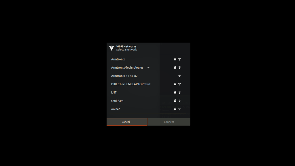

Power On the board, it will starts hosting an Wifi Access Point.
Using a android phone or laptop connect to this AP (Image 25).
Once Connected to this AP type 192.168.4.1 by opening a browser (chrome/firefox) from the AP connected system/Phone. Make sure you are not using your data connection(3G/4G).
On typing the IP, a webpage will open where the follow has to be entered (Image 26).
- SSID: Wifi AP name.
- Password: SSID Password.
- IoT mode Mqtt or Http (Select Mqtt ).
- Mqtt Broker IP (In our case it is 192.168.1.67).
- Mqtt user name and password, as we are using authentication type, we have used Naren , xxxx
- Mqtt publish topic: This will be on which topic the board publishes too, we have used /testpub.
- Mqtt subscribe topic: This will be on which topic the board listens to for commands to trigger the triac, we have used /testsub.
- Device name: It is the name you call out to alexa for triggering the board, we have used corvi.

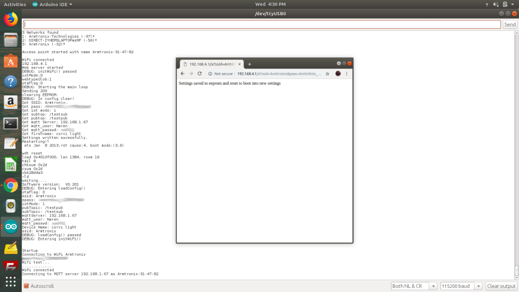

After entering the details, Press the submit button, on doing this you will get a screen as shown in the Image 27, wait for some time till the board stops hosting the AP.

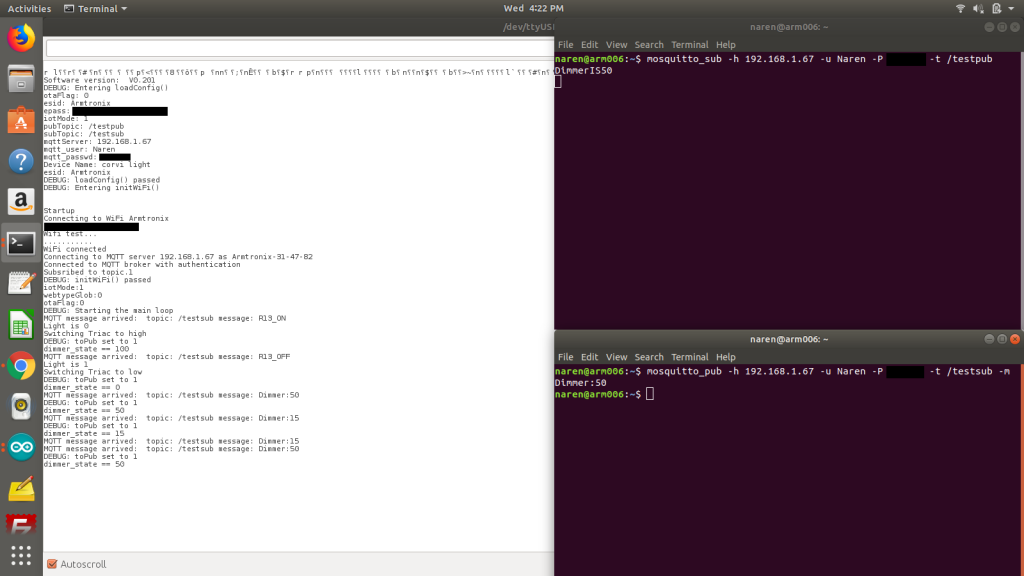

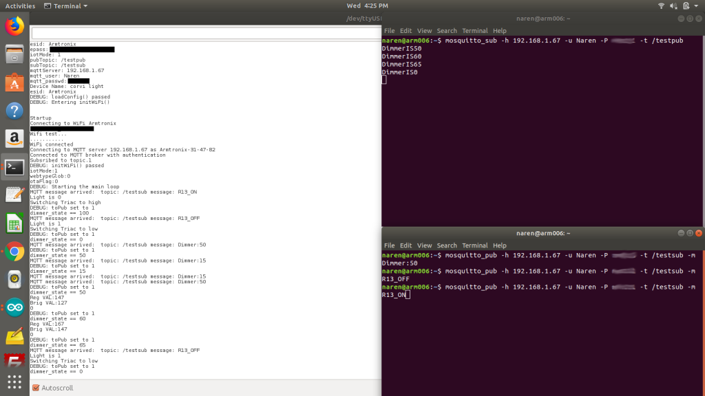

Please note that we have connected our board via Uart to the serial monitor of Arduino IDE. So on the left hand side you will see the debug messages it prints via Uart (this is just for your reference).
Once this is done you can view the debug screen. Most of the details will be visible there. After this, it will successfully connect to the broker on the debug (serial) screen you can see this.
Connected to MQTT broker with authentication. Subscribed to topic 1.
After it prints this you can now start sending it commands via mqtt on the topic it has subscribed to i.e. /testsub/

To send this command from a ubuntu based system where mqtt client is installed, just type it as show below . Two additional parameters are added here because of authentication — i.e -u which is the user name and -P is the password, please note that these are case sensitive .
mosquitto_pub -h 192.168.1.67 -u Naren -P xxxx -t /testsub -m R13_ON
mosquitto_pub -h 192.168.1.67 -u Naren -P xxxx -t /testsub -m R13_OFF
mosquitto_pub -h 192.168.1.67 -u Naren -P xxxx -t /testsub -m Dimmer:50
Note: 50 is the dimmer value
mosquitto_pub -h 192.168.1.67 -u Naren -P xxxx -t /testsub -m Status
For the latest status, the status gets printed on the publishing topic of the board which in our case is /testpub .On our board any change in the device is printed on the publishing topic of the board. For example, if we pass Dimmer:50 on the board subscribed topic than on physically executing this, the board will send a message stating the dimmed level on the publishing topic. Example is shown below,
To subscribe from your ubuntu system to the publishing topic of the board enter the following command
mosquitto_sub -h 192.168.1.67 -u Naren -P xxxx -t /testpub
message we get is
DimmerIS50
a few screen shorts of the same are below (Image 28, Image 29)
