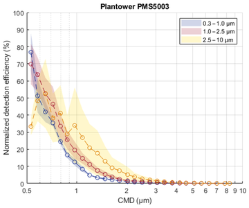

The three particulate matter sensors shown in this article are:
- the Plantower PMS5003 using a serial connection;
- the Sensirion SPS30 using i2c;
- the Omron B5W LD0101 with pulse outputs.
These optical sensors are similar to the ones found in one type of domestic smoke alarm but they differ in their attempt to count particles of different sizes rather than just alarm at a threshold concentration.
The red laser-based PMS5003 is a commonly used hobbyist sensor and can be found in the PurpleAir PA-II air quality sensor. The SPS30 is a more recent sensor using the same principle and can be found in the Clarity Node-S air quality sensor. The infrared LED-based B5W LD0101 sensor has a more primitive interface but is useful for its ability to detect particles larger than 2.5 microns - the other two sensors cannot reliably measure these.

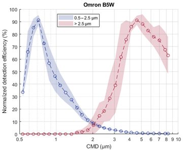

The Omron B5W LD0101 sensor is unfortunately being discontinued by the manufacturer with last orders in March 2022.

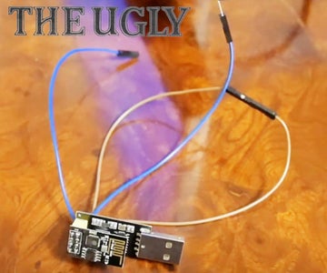

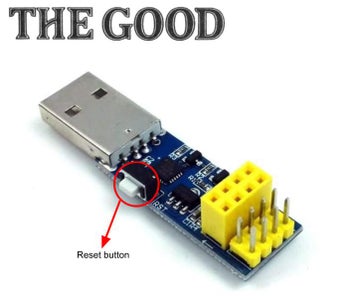

Step 1: USB Programmer for Updating Flash on the ESP-01S
The ESP-01S module is unlikely to come with appropriate AT firmware on it unless it is from Cytron. The easiest way to update it is to use a Windows desktop or laptop with a USB adapter which write-enables the flash and has a reset button. Unfortunately a very common, no-brand adapter often described as something like an "ESP-01 Programmer Adapter UART" does not have buttons or switches to control these. The video above shows how this can be quickly retrofitted with some improvised switches made from two male-to-female jumper wires cut in two and soldered onto the pins on the underside of the programmer board. An alternative approach to this using a breadboard can be seen in Hackaday: ESPHome on ESP-01 Windows Workflow.
Step 2: Updating Firmware on ESP-01S Using Windows
A terminal program like PuTTY can be used with the ESP-01 Programmer to check the firmware version. The firmware makes the ESP8266 act a bit like a modem with commands inspired by the Hayes command set. The AT+GMR command shows the firmware version.

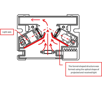

The B5W LD0101 uses convection for its airflow and must be placed upright to work correctly. A change of supply voltage is likely to affect the temperature of the heater and the associated airflow. Ambient temperature must also have an effect.

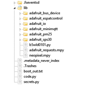

Step 8: Installing CircuitPython and Sensor Data Publishing Program
If you are not familiar with CircuitPython then it's worth reading the Welcome to CircuitPython guide first.
- Install the following seven libraries from the version 7.x bundle from https://circuitpython.org/libraries into the lib directory on the CIRCUITPY drive:
- adafruit_bus_device
- adafruit_minimqtt
- adafruit_io
- adafruit_espatcontrol
- adafruit_pm25
- adafruit_requests.mpy
- neopixel.mpy
- Download these two extra libraries to the lib directory by clicking Save link as... on the files inside the directory or on the file:
- adafruit_sps30 from https://github.com/kevinjwalters/Adafruit_CircuitPython_SPS30
- b5wld0101.py from https://github.com/kevinjwalters/CircuitPython_B5WLD0101
- Create the secrets.py file (see example below) and fill in the values.
- Download the program to CIRCUITPY by clicking Save link as... on pmsensors_adafruitio.py
- Rename or delete any existing code.py file on CIRCUITPY, then rename the pmsensors_adafruitio.py to code.py. This file is run when the CircuitPython interpreter starts or reloads.

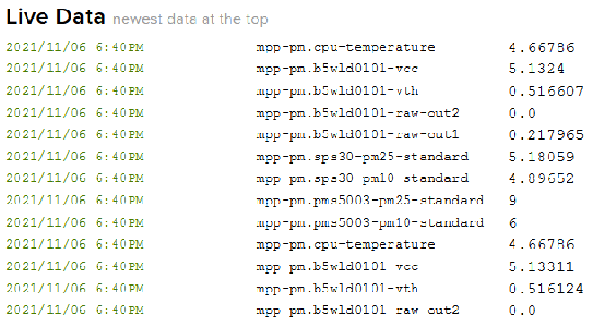

Step 10: Verifying the Data Publishing
The Monitor page under Profile is useful to verify data is arriving in real-time by looking at the Live Data section. The program turns the RGB pixel blue for 2-3 seconds when it sends the data to Adafruit IO and then returns to green.
The temperature from the RP2040 appears to vary widely between different CPUs and is unlikely to match ambient temperature.

Step 12: Particulate Matter Outside on Guy Fawkes Night
Guy Fawkes Night is associated with bonfires and fireworks which can contribute to an increase in air pollution for an evening or two. The charts above show the three sensors being placed outside just after 7pm on Friday 5th November 2021. There were no fireworks in the immediate vicinity but they could be heard in the distance. Note: the y scale varies between the three charts.
The feed data stored in Adafruit IO shows the sensors detecting the air already had a slightly raised level of PM2.5 based on the SPS30 numbers:
2021/11/05 7:08:24PM 13.0941
2021/11/05 7:07:56PM 13.5417
2021/11/05 7:07:28PM 3.28779
2021/11/05 7:06:40PM 1.85779
The peak was around 46ug per cubic metre just before 11pm:
2021/11/05 10:55:49PM 46.1837
2021/11/05 10:55:21PM 45.8853
2021/11/05 10:54:53PM 46.0842
2021/11/05 10:54:26PM 44.8476
There are short spikes elsewhere in the data when the sensors were outside. These could be due to wafts from:

Step 15: Comparison of Sensors - Particle Size
The graphs above are from the Laboratory evaluation of particle-size selectivity of optical low-cost particulate matter sensors by the Finnish Meteorological Institute. Three sensors of each kind were tested with different particle sizes shown on the logarithmic x axis. The coloured lines indicate the calculated values of specific particle size bands based on the sensor outputs, the banding shows the distribution. The three SPS30 values above 1 micron overlap heavily making them very difficult to distinguish.
The common metrics for particulates are PM2.5 and PM10. While the number in the name refers to the maximum size of the particle the units are in micrograms per cubic metre. The inexpensive sensors can only measure particle diameter (volume) and have to make some guesses about density to calculate the likely PM2.5 and PM10 values.
The PMS5003 uses a constant density value, Sensirion describe their density approach for the SPS30 as:
Most low-cost PM sensors on the market assume a constant mass density in calibration and calculate the mass concentration by multiplying the detected particle count by this mass density. This assumption only works if the sensor measures a single particle type (for instance, tobacco smoke), but in reality we find many different particle types with many different optical properties in everyday life, from ‘heavy’ house dust to ‘light’ combustion particles. Sensirion’s proprietary algorithms use an advanced approach that allows a proper estimation of the mass concentration, regardless of the particle type measured. In addition, such an approach enables a correct estimation of the size bins.
The PM metrics encompass all of the particles below the size parameter, i.e.
PM1 + mass of all the particles between 1.0 and 2.5 microns = PM2.5,
PM2.5 + mass of all the particles between 2.5 and 10 microns = PM10.
The PMS5003 and SPS30 are unable to detect the particles in this laboratory test above 2-3 microns. It's possible they may detect other types of particles above this size.
The B5W LD0101 looks credible from this laboratory test for measuring PM10.
Step 16: Comparison of Sensors - Design
The Omron heater (a 100 ohm +/- 2% resistor!) can be seen if the sensor is turned upside-down. The design is discussed in detail in Omron: Development of air quality sensor for air purifier. The use of convection seems crude but it can be a higher reliability solution compared to a mechanical component like a fan which has a finite lifetime and a lifetime that may be reduced by operating in a dusty environment. The SPS30 fan appears to be designed to be easily replaceable without opening the case. Other Plantower models have the same design feature.
All three of the sensors will be prone to the effects of high relative humidity which unfortunately erroneously increases the PM values.
