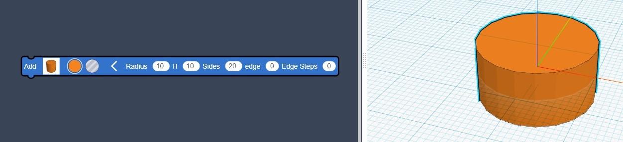

Let’s get familiar with the 3-axis coordinate system in Tinkercad. The Origin is the center of the grid where X, Y, and Z all equal 0.
When a cylinder is added to the Workplane it is centered on the Origin, so half of it is below the Workplane.

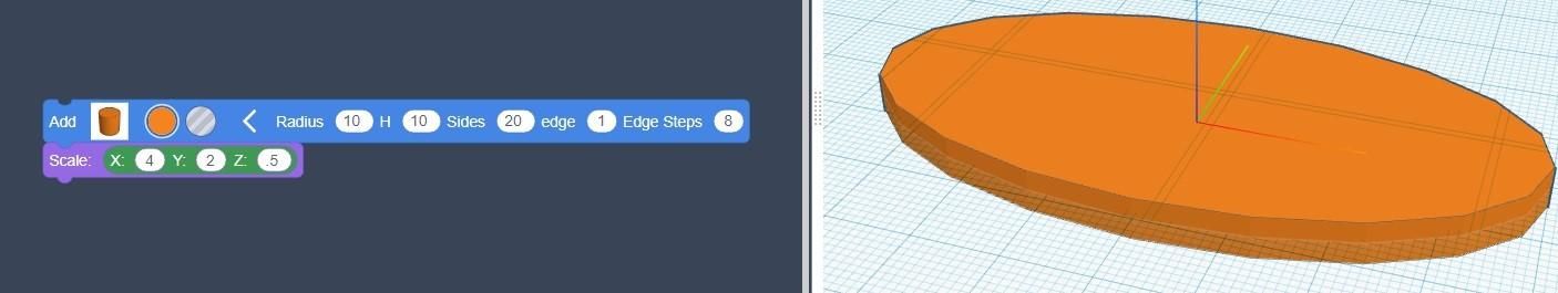

To change the shape use a Scale block.
To round the edges (it's hard to see, but it's there), set “edge” to 1, and increase the number of “Edge Steps”

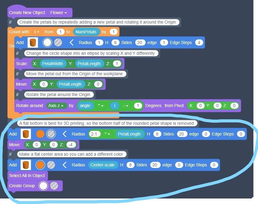

Step 3: Create the Petals
In this code each petal is created with radius 1 for easy scaling. It is then moved out from the Origin of the Workplane, and rotated around the Origin to its proper position.
“Count" loops use a counter variable, often called “i” or “j”. In this code the counter “i” is used to calculate the rotation angle for each petal. It starts with “i -1” so the first petal is not rotated.

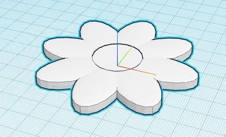

As you may have noticed, all the shapes come in centered on the Origin, so at this point the Daisy is half above and half below the Workplane. The bottom half can be removed by creating a Hole Cylinder a little bigger than the daisy, moving it below the Workplane, then grouping.
I added a flat center before creating a group, I can decorate it or add a center of a different color.
The flat center is slightly above the petals, though it looks like it is below in the image.

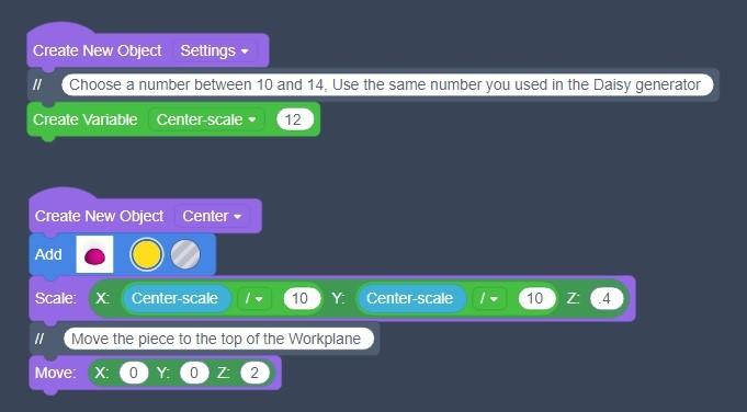

Step 4: Create the Center
Here you need to make a choice whether to create the daisy in 1 piece or 2.
If it will all be one piece, add this code to your existing code.
If you choose to make it in 2 pieces, create a new design and add this code.
The code described above is called Daisy Generator and can be found at
www.tinkercad.com/codeblocks/0p8K3ObtH0h
The separate code for the Center can be found at www.tinkercad.com/codeblocks/coqtvWYl1GX
