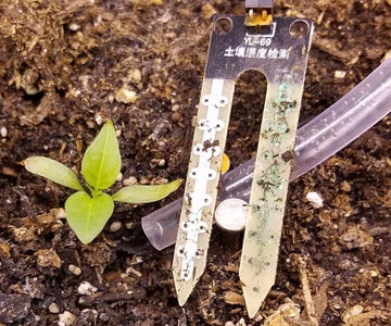

The resistive soil moisture sensor has a small control board which connects to the probe. The analogue output voltage is the voltage across the soil from a simple potential divider with the other resistor being 10kohm. This board features a digital output based on a threshold set by the potentiometer which is not used here. The maximum power consumption for this board was measured at 3.03mA with both LEDs on and the probe shorted. This low current allows this particular sensor to be powered by a GPIO pin. The current limit for each output on the RP2040-based Pi Pico are not clear but 10mA is a reasonable conservative guess at a maximum.
If you are using a different sensor check its data sheet or measure the current with the two electrodes shorted to ensure it's below 10mA before using GPIO to power it.
Three female to female jumper wires are needed to connect the control board to the Maker Pi Pico:
- VCC - GP16 (red) or use 3V3 for higher current sensors,
- GND - GND (black),
- D0 - not needed, leave unconnected,
- A0 - GP26 (blue).

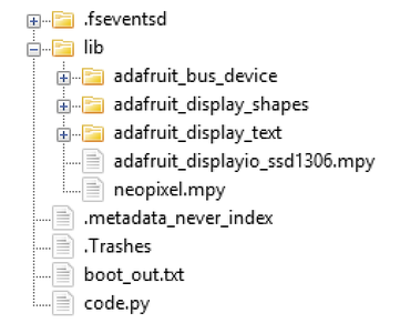

- Install these libraries from a recent bundle from https://circuitpython.org/libraries into the lib directory on CIRCUITPY:
- adafruit_bus_device
- adafruit_display_shapes
- adafruit_display_text
- adafruit_displayio_ssd1306.mpy (not adafruit_ssd1306.py)
- neopixel.mpy
- Download the example program to CIRCUITPY by clicking Save link as... on soil-moisture.py
- Rename or delete any existing code.py file on CIRCUITPY, then rename the soil-moisture.py to code.py. This file is run when the CircuitPython interpreter starts or reloads.

Some garden compost was dried in a low oven for a few hours and then placed into a dry pot with a volume around 780ml (26.5 fl. oz.). The two soil sensors were inserted into the soil 75mm (3in.) apart. The room-temperature tap water was added in 10ml (1/3 fl oz.) increments every ten minutes by dripping it onto the surface of soil with most in the middle of the pot but some around the edges too. The graphs shown above were created from manual recording of the ADC values shown on the small screen. The resistive graph uses error bars to indicate how the value dramatically dropped as the water was added and then quickly climbed back up to a stable value as the soil became sodden. Water seeped out of the drainage holes in the pot at 290ml.
Observations and thoughts:
- Soil is very unlikely to get as dry as the starting point particularly for house plants. This probably made the soil overly dense too.
- The values for 0-40ml would probably be lower if more time was allowed for the water to spread evenly into the soil, although very dry soil is likely to be hygroscopic to some extent further complicating things.
- The seating of the sensors in the soil makes has a large effect on the output value, more so on the resistive sensor. Nudging them or re-inserting them can radically change the value.
- The resistance value drops slightly if the polarity of the resistive sensor is reversed and then it climbs back to original value over a few minutes. This suggests a small degree of electrolysis is taking place in the nearby soil.
- The sensors do not appear to affect each other at this separation distance.
- Soil type has a significant effect on the output value. This was noted later with the soil which came with the rosemary plant.
- The presence and activity of roots would change the output value.
- Plants in pots might use perlite and vermiculite to regulate moisture. Bark, mulch and straw might be used for outside plants. These must have some effect on the output value.
- Capacitive sensors tend to have pcb tracks on one side only. This is likely to cause them to be more sensitive on that side. They are best inserted facing the bulk of the soil and not close-up, facing the side of the pot.

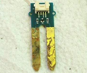

Step 5: Resistive Sensor Electrode Corrosion
The voltage used by a resistive sensor causes some degree of electrolysis over time which hastens corrosion shortening the life of the electrodes, particularly the anode. The photographs above of a matching probe from a Raspberry Pi Stack Exchange question and different model from http://homecontrols.ch/gardening.php. This is undesirable in terms of:
- sensor lifetime,
- deterioration in the quality of measurements and
- the transfer of unknown metals of unknown purity into the soil where they may end up in the (edible) plants.
This can be minimised by only powering the sensor for short periods. If the polarity on the two-pronged sensor can be swapped over periodically this would help a little to extend the life of the sensor. The sensors with ENIG gold-plating will last a little longer but as can be seen this plating process is still not good enough to prevent corrosion of the electrodes.
The capacitive sensors appear far superior in terms of corrosion because their design does not require exposed metal allowing the solder mask layer to protect the top and bottom surfaces. Seeed Studio mentions this on the page for their resistive sensor (operating current 35mA):
This sensor is not hardened against contamination or exposure of the control circuitry to water and may be prone to electrolytic corrosion across the probes, please use it for PROTOTYPING ONLY. We also offer Grove - Capacitive Moisture Sensor with corrosion resistance.
