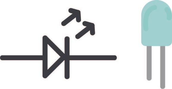

Step 3: LED
On the left is the schematic diagram and on the right is the realistic illustration.
You will notice that one leg of the LED is longer than the other. The longer leg is called anode and connects to power and the shorter leg is called cathode.
Tip - (The black - is usually ground in circuits and red + is power.)
What is an LED?
An LED is a diode that lights up when electricity passes through it.
LED = Light Emitting Diode

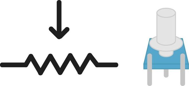

Step 6: Potentiometers
A potentiometer is a component that you can twist to angles you can read.
How it works
Inside the potentiometer is a circular disk of metal going between the front two legs. The middle knob is a piece of metal that touches the ring at the point it is facing.
Finally, the third leg reads the resistance between the two legs and the knob.
All of this results in us reading the angle of the knob.

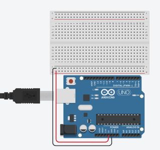

Step 9: Getting Started
Pull out the Arduino and bread board and lay them out on the work plain.
Next wire 5v to +/positive and then ground to -/negative.
You can colour the wires, but it won't affect your circuit if you don't.

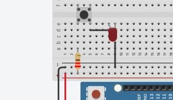

Step 10: The Button
You then need to wire a 220 ohm resistor to the a push button.
Without the resistor the 5v would be too much for the button and the LED.
The resistor must also be wired to positive, as that has the electricity going to it.
You can change the resistance of the resistor in the top right as shown.
Step 11: The LED!
In this step, add an Led to the board rotating it, so that the long leg(anode) is connected to power.
You can rotate the LED at the top left corner.
Put a wire between the push button and the anode leg and then from cathode to negative(ground)
Tinkercad allows you to explore Arduino without the risk of frying your circuit!
Now we are all done.
Click on the run simulation and what your LED illuminate as you press the push button!
