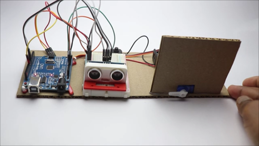

Step 1: Circuit Diagram
The favourite part of mine is building the circuit, This circuit is very simple to make and i will explain how you can make this in no time.
The circuit can be divided into 2 steps, the first is the hcsr04 part circuit and the second is the micro servo circuitry.
The Hc-Sr04 or called as ultrasonic sensor comes with 4 pins, Here the Gnd and Vcc pins are directly connected to the Gnd and 5v pin on the Uno board.
The Trig and Echo pins are connected to the D7 and D6 pins of the uno board, Here I have connected both of these pins to the uno board directly while the rest 2 pins are connected to the power rails of the breadboard.
Let us connect the servo too, The servo has 3 pins, The signal, the positive and the negative.
Connect the signal pin directly to the D10 pin of the uno board where as the power pins will be connected to the power rails on the breadboard.
Use jumper wires to establish the connection between all these components, After this is complete we will upload codes to the uno board.

Step 3: Assembling
Coming to this part there are other alternatives like using the 3d printed parts and a full enclosure, But I found using the cardboard board does the job and it looks great too.
Place the arduino uno on the board followed by the breadboard and servo, and use a tiny amount of hot glue to glue all these components to the board.
To make the servo holder, cut a square piece of cardboard and to the base taking reference of servo cut a small slot, Glue the holder to the cardboard base, and allow it until it is dry.
I added a little extra touch by casing the ultrasonic sensor with a 3d printed part, This is an optional step and if you don't have a case you can simply glue it to the baseboard or breadboard.
Here you should make a note that the sensor is glued to the side and no obstacle should be there in front of the board.
Step 4: How to Use
Using this project is very simple, Turn on the power button given at the backside of the board and make sure there is no obstacle placed in front of the sensor.
For your reference in the beginning you have to place a ruler and keep any obstacles in front of the sensor, note down the readings, and mark the measurements on the meter.
After a few attempts the servo becomes stable and will start to show the accurate readings, note that the limit here is 20cms and above this, the servo starts to jitter.
This completes our project and by now you should be measuring the small distances with this project! Note that this is just a prototype to show the abilities of arduino, you cant use this project to take measurements like a precise scale, but this does the job.
