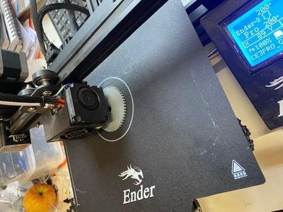

The clock hands and gear mechanism was designed using Fusion 360, the gears were then printed on a 3D printer. I found the combination of using my 3D printer together with Fusion 360 meant I could rapidly prototype many different designs before I got to the final gear train design.
Each hand is driven by a stepper motor through a pair of spur gears, the pinion gear is connected directly to the stepper motor and the driven gear is on the 8mm brass axle. Each gear has a 2:1 reduction, this is to take the torque load of the the stepper motor hopefully increasing the life of the motor. The hour hand has a 25:50 gear ratio and the Minute hand has a 30:60 ratio.
The hour stepper motor turns the axle through the 50 tooth gear. The 50 tooth gear is secured to the axle with a locking collar. The hour hand is the driven by the shaft, also being connected via a locking collar. The minute hand is on the 60 tooth gear which can freewheel around the 8mm shaft, this is driven by the minute stepper motor and the 30 tooth gear.
The spur gears were designed using the Fusion 360 spur gear add in, this functionality being very important for this project. The way I designed the gears was as follows:
  1. Click the utilities Tab
  2. Click on the Scripts and Add-ins on the tool bar
  3. Scroll down to spur gear and select run
  4. A menu will then a appear to enter your gear parameters
  5. Click run and your gear will appear on the screen
Once the gear was generated I then added the shaft with the required flats to connect to the motor.
The gears that needed to be coupled to the axle were fitted with a locking collar. I connected the steel locking collar to the gear using 2-part epoxy glue. The 8mm brass shaft was used to make sure the collar was correctly aligned.
Once all of the gears were designed on Fusion 360 the files were exported as an stl file. The stl file was then opened up in Cura and sliced ready for 3D printing. With Fusion 360 there is the option to automatically generate the stl file and send to Cura directly, Fusion 360 also opens Cura with your print ready to slice. The 3D printing was done with a Creality Ender 3 Pro. The small gears took about 20 minutes each to print and the large gears took about an hour to print. The clock hands were also designed on Fusion 360 and 3D printed the same way.

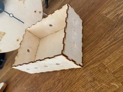

Step 2: Plywood Clock Face and Enclosure
The main clock face, electronics enclosure and supports were manufactured from 3mm plywood. This is a fairly straightforward 2D design so I used a simple 2D CAD package to design the clock face and supports.
I tried to find some pictures of a chemical flask, DNA and an atom on line to download with no luck so they were drawn from scratch.
I cheated for the electronics enclosure as I used an online box making tool. I used makercase.com. With this tool you put in all your settings for your enclosure and it then generates a drawing of the box of which you can download dxf and svg files. This tool is awesome for quickly designing boxes!
Once the drawings were done it was time to cut out the parts using a laser cutter. The laser cutter at the hackspace I am a member of uses LightBurn software which seems pretty compatible with most file formats. I find using an engineering CAD package quite useful as I can use different layers for different types of laser cuts, for example the outline can be drawn in a layer for a full cut, the text engraving can then be a different layer with a lower intensity. The LED holes were another layer so the cut sequence could be optimised. The small LED's are 5mm so the holes were 6mm.
To secure all the plywood elements I just used standard wood glue.
