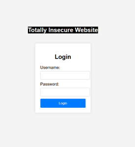

I decided to setup a super simple website running on my LAN. This website included a login page, a php script to handle the username and password, a login failed page and a main page you are directed to if there's a successful login. It's important to understand how this process works to get the most out of hydra.

HTML Login Page(login_page.html):
  • The HTML code defines a simple login page with a form containing fields for username and password.
  • When the form is submitted, it sends the data to the server using the POST method.

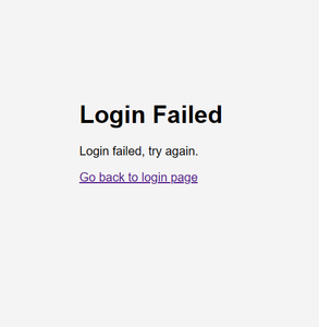

  • If the validation fails (i.e., the username and password do not match), it redirects the user to login_failed.html which has a link to send the user back to login_page.html. This page is very important because Hydra will use the information on this page to identify that the password used was unsuccessful, therefore having another go at cracking the password.

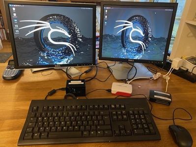

For the attack machines I used two Raspberry Pi's, one Pi 4 and one Pi 5. To turn them into mini cyber warriors I installed Kali Linux on both Pi's.
Here's how to setup a Raspberry Pi with Kali Linux:
1. Get Your Pi's Ready
Obtain a Raspberry Pi board (such as Raspberry Pi4 or Pi5 ) and the necessary peripherals (power adapter, microSD card, keyboard, mouse, monitor, etc.) Ensure the Raspberry Pi is in working condition and properly assembled. I put air cooling Systems on both the Pi's I was testing.

4. Boot Raspberry Pi with Kali Linux:
Insert the microSD card containing the Kali Linux image into the Raspberry Pi's microSD card slot.
Connect peripherals such as keyboard, mouse, and monitor to the Raspberry Pi. Power on the Raspberry Pi by connecting the power adapter. The Raspberry Pi should boot into Kali Linux. Follow the on-screen instructions to complete the initial setup.

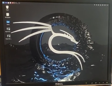

5. Configure Kali Linux:
Upon first boot, you'll be prompted to set up various configurations such as language, time zone, keyboard layout, etc. Follow the prompts to complete the setup process and create a user account with a username and password. You REALLY want to change the default password otherwise someone will definitely hack into your machine (probably through SSH). This happened to me (accidently on purpose) by a a friendly hacker in my local hackspace.

Finally, the :F=Login Failed part specifies the failure condition. Hydra will interpret a response containing "Login Failed" as an indication that the attempted login was unsuccessful. Once Hydra finds a successful username and password the process stops and the username and password is given.
