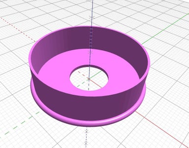

Step 2: Design
The project was designed using BlocksCAD and consists of the following elements:
The dimensions of the Spindle and Protective Body to be 3D printed are:
Spindle: 11.8 (L) x 11.8 (W) x 28 (H) mm
Protective Body: 34.8 (L) x 34.8 (W) x 10 (H) mm
The Spindle simply pushes into the centre of a pair of stacked disc magnets and enables the used to rotate the spinner.
The Spindle and magnet combination fit into the Protective Body which supports and protects the magnets from damage due to impacts.
A ball bearing is inserted up through the centre hole in the Protective Body and held in place by the magnetic field.
The spinner rotates on the ball bearing.
Although, I have 3D printed the main supporting elements which gives it a degree of permanence, this is not absolutely necessary to make the project.
These can simply be substituted with tape wrapped around the magnets to replace the Protective Body and a dowel suitably shaped to replace the Spindle.
However, feel free to experiment with different materials.
