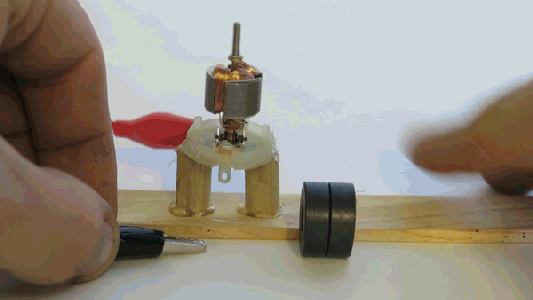

Step 4: Make a Base
Raise your motor to the sky!
With some wood extras, it isn't too hard to make a base for our motor to spin on. There are many solutions to this, but I cut two short pieces of dowel, glued them on a stirring stick, and glued the motor base on to that. I left the two motor tabs exposed on the sides for easy connecting.
Step 5: Make a Motor
Here's the fun part!
You can set up your motor however you like. You can put a tape flag or leave it, but the essential part is grabbing your two extra magnets to play with. Use the gator clips to hook up your motor. Putting them close to the rotors in the right orientation will get the motor running elegantly and extremely quickly.
Here are some wonderful things to try and notice:
  • What orientation do the magnets have to be in to make the motor spin? Try flipping them mid-way.
  • What happens when they get closer? Farther away?
  • What happens when just one magnet moves away?
  • Try starting your motor with one hand with only one magnet. Why does it do what you see?
  • What happens to the circuit if you don't put magnets near? (heat)
  • What happens when you add more magnets in a ring?
  • Try substituting your magnets for stronger ones. What happens?
  • Notice the spark and arcing happening where the brushes are touching the commutators.
