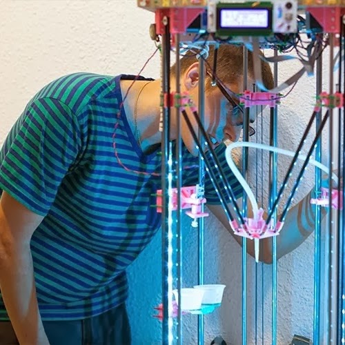

Introduction: Testing Food for 3d Food Printing
About: My name is Luis, I am from Barcelona and for the last years I've developed a curious obsession merging food and rapid prototyping. To have a unique and customized eating experience.
The goal of this instructable is to test food and evaluate their compatibility for 3d food printing. Experimenting with ingredients and packaged food from the supermarket.
This is a work in progress. Feel free to suggest new ones!
