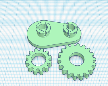

Step 1: The Gears
The gears are made of useful gears as these are nice and smooth. Here are the settings:
pitch - 2
slop - 0.01
#of teeth - 12
height - 20
bore dia - 10
The second gear is the same but with 18 teeth.
(1.5 x faster as 18/12 = 1.5)
By playing around with the number of teeth you can create gear ratios.
Gear ratios spin at different rates!
The cogs are at an angle so that they can bind therefore spin together.

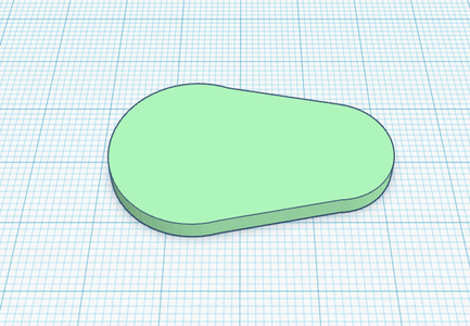

Step 2: The Base
The base is made up of two cylinders of the same diameter as the cogs.
Align these so they fit in shape.
These are joined together with two boxes at the same height as the cylinders.
my base is layered at 3mm high.

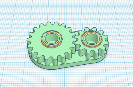

Step 3: The Axle
This is the bit this that the two gears will spin around on.
The two axles are made of tubes just smaller that the bore diameter of the gears.
To stop the gears coming off the axle I added a second tube higher than the gears and a 0.25mm bigger diameter.

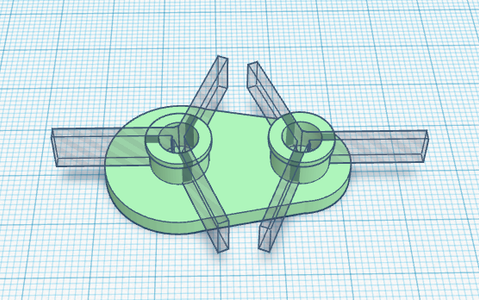

Step 4: The Pin
For some flexibility room I created 3 holes in each axle using boxes.
we need flexibility as it will allow us to push on the gears.

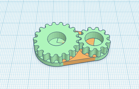

In this stage I moved the gears off of the base and onto the floor where they can be printed.
In the gears I cut out two cones to ease on the fit.
Now it is ready for printing so you can export your model.

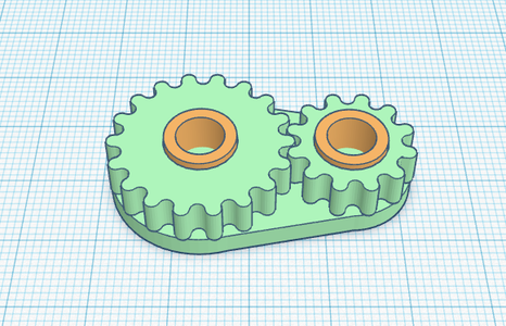

Step 6: Finishing Up
The gears should pop on to the pegs with a little force and spin freely.
