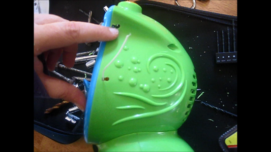

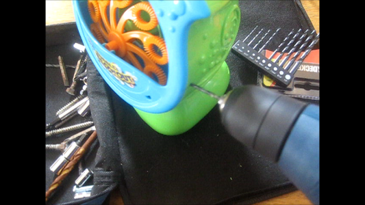

Step 1: Pull Wires From Bubble Machine
Take the batteries out of your bubble machine before you hack it. Locate the wires that go to and from the switch. Check out the video and pictures to see how I drilled the bubble machine and pulled the wires. Separate the wires, put the batteries back in your bubble machine and use a voltmeter to determine which wire is positive and which is negative. Use black electrical tape to keep track of them and keep them apart. When you touch the wires together, the bubble machine should turn on.

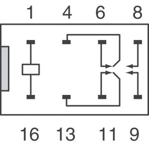

Read the datasheet that comes with your relay, because all relays are somewhat different.  The littleBits wire is smaller than the recommended 22 gauge wire most people use for breadboards, so you might need to use alligator clips with jumper wire to connect the littleBits wire to a breadboard.  Connect the orange signal wire to the relay's positive Input 1, and the white ground wire to the relay's negative Input 2.  Poke around with your multimeter and use your datasheet and knowledgeable adult to determine which leads you should connect to your bubble machine wires.
I used an OMRON G5V-2 relay, which is DPDT, but you could use any 5V relay.  The image of a relay schematic on this step is for my relay.
