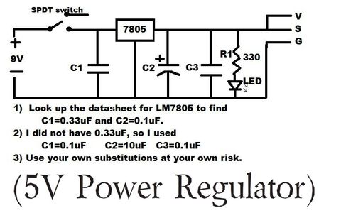

If you are concerned about frying littleBits while testing the wireless power transfer coil, I recommend you build a 5V regulator circuit. For complete instructions on the 5V regulator circuit, including parts, visit my DIY littleBits 'ible, Step 1: POWER!.

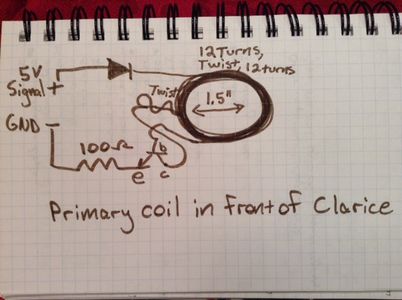

PRIMARY COIL:
Wrap 30 gauge wire 12 times around a 1.5 inch cylinder, leave about 1 inch out to twist, then continue around the cylinder 12 more times in the same direction. There should be two 3-inch leads and a center twist. Fasten the coil together temporarily with tape to prevent unraveling. Don't use hot glue, because it will liquify in the oven.
Breadboard these points for the PRIMARY COIL:
  1. collector of NPN transistor to the twist
  2. base of NPN transistor to a coil lead
  3. negative side of diode to other coil lead
  4. emitter of NPN transistor to 100 ohm resistor
  5. positive side of diode to + 5V (signal littleBits)
  6. other lead of 100 ohm resistor to - 5V (ground littleBits)

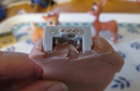

Step 2: Baking Components in Super Sculpey
Condition the clay until it is soft. The intent is to hide electronics while maintaining an even footing for characters and a thin enough layer of clay between coils so that the coils get close enough together. It's ok if snow looks lumpy and messy. :)
Clarice's area / PRIMARY COIL
String the two insulated wires to the left. They can hang out an inch beyond Clarice's snow platform. Fit the bitsnap into the snow, but don't solder it in place yet, and don't bake it with the clay.
Rudolph's footing / SECONDARY COIL
I left this coil exposed in a channel on the bottom. That's because I want to be able to explain it to other people. Whatever you decide, make sure you continually test functioning every step along the way. The farther apart the coils are, the dimmer the red led will be. I shoved Rudolph's feet into his footing, but did not bake him with it. After it cooled, I hot glued his feet to the footprints.
Once you are finished sculpting, bake according to manufacturer's instructions: 275 degrees F for 15 minutes per 1/4 inch. To minimize baking time and risk of melting the transistor, keep the clay up to 1/4 inch thick. Once cool, hot glue Rudolph to his footing, his coil to his footing channel, and his led to his nose (I cut off his original nose with wire cutters). Hide wires up the side of his body. Solder the signal and ground wires to a male bitsnap. Test with littleBits power and button. Paint the snow white.

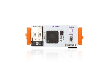

Build this littleBits circuit:
USB power + button + CloudBit + Clarice & Rudolph
Follow initial bootup instructions for the cloudBit, according to the littleBits website:
Use the button for testing CloudBit connectivity in cloud control.

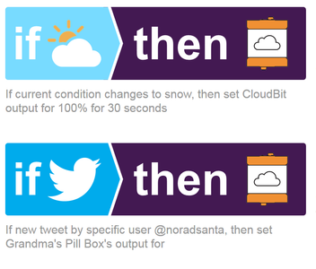

Create recipes at www.IFTTT.com . Here is one I already made:
Whenever @NoradSanta tweets, Rudolph's nose glows for 30 seconds.
There are lots of channels on IFTTT. You could even make a recipe that makes Rudolph's nose glow when there is snow! Try making a recipe using the Weather Channel - IF current conditions in your area = snow THEN set CloudBit output to 100% for 30 seconds.
