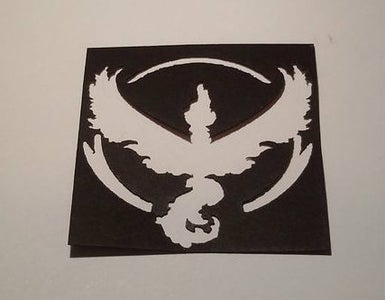

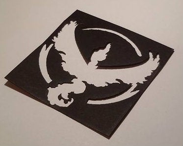

Step 2: Prepare the Cut-out of Moltres (Team Valor Emblem)
This part will be really easy if you have a laser cutter. I found an image of the Team Valor Emblem online on Jackaloupe's blog and then used an online image to .DXF (common file type for CAD drawings) converter to prepare the image for the laser cutter. Then I uploaded the DXF file to a laser cutter I have access to at school and viola! We have our Moltres cut-out.
If you do not have access to a laser cutter, I would suggest a hobby knife and transparency from your local Hobby Lobby.

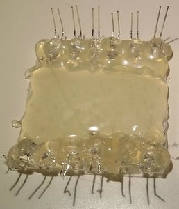

Step 4: Placing the LEDs Onto the Acrylic
Glue the LEDs on to the piece of acrylic with LEDs on opposite sides of the acrylic facing each other. Then place glue to fill the space between all the LEDs. The hot glue acts as a light diffuser. Thanks Kurt E. Clothier!

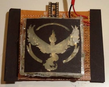

Step 7: Attach Your Team Valor Emblem
Glue (or however you prefer to attach it) your Team Valor cut-out onto the front side of the piece of acrylic.

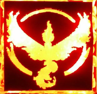

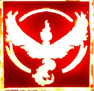

Step 8: You Are Done!
Attach the batter and watch it light up!
