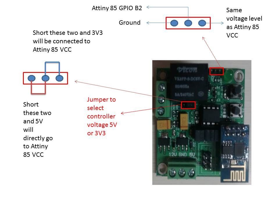

Once you plug the module on to its header it will look as shown in figure.Once that is done you can power it up using a 12-7 V DC power supply or a 5V -5.3V DC Max .The figure shows the point where one needs to connect the power supply .Please do not apply voltage above recommended voltage specially on the 5V input side as on one of the jumper setting shown in figure will be directly connected to the microcontroller.

On the board you will be able to find an open GPIO pin directly from the Attiny 85 controller (refer fig) .Which can be used either as input(default code it is set as input ) or output. You will be able to connect sensors like PIR to it .In addition we have also provided a VCC and Ground pin on the same header .The VCC pin will be at the same voltage level as that of the Attiny 85 microcontroller which depends on the previously mentioned jumper selection of VCC voltage to the controller .These things are clearly shown in the figure .If you wish to connect an external relay you will be able to connect it through a transistor circuit using the Attiny 85 gpio and by changing the Attiny 85 code.In this instructable I have connected it to a PIR sensor.As the PIR sensor runs at 5V ,this voltage is tapped from one of the headers.
