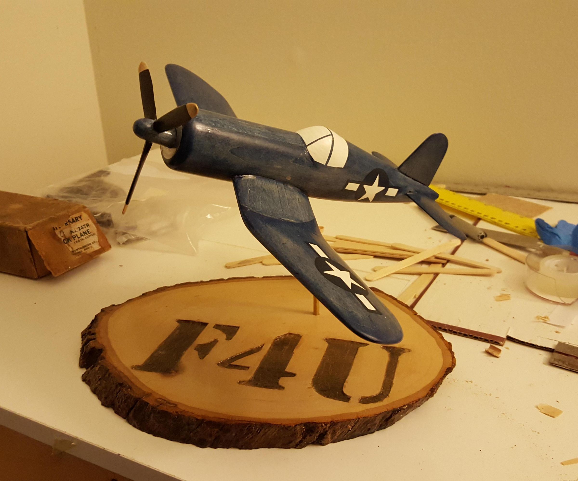

Step 12: My Design Process
From the outset I knew that I wanted to design a warbird that was different from all those that came before it to make it one of a kind. I also knew that I wanted to make it fully sheeted with balsa and fiberglass, because I love the look of wood. Additionally, I wanted to include retractable landing gear to not only reduce drag, but also to make the airplane look more complete in the air. From the outset these requirements made it the hardest but most rewarding airplane that I have ever designed and fabricated. I encourage anyone who has been flying to try to design and build at least one airplane of your own, whether it is simple or complex it is a great learning experience. Below is the preliminary steps I took to design the airplane.
  1. Sketch the airplane- First I drew my preliminary design sketch on graph paper without any dimensions. This allows you to scale the sketch to any size that you want and will allow the wing area to be found for different wingspans.
  2. Weight estimation- Once the preliminary wing area was found I then started making a weight build up of all of the major components. This stage was very much a reality check. My initial plan was to have a 45 inch wingspan however with the components, and the weight of the wing sheeting I quickly found that the airplane would have too high of a wingloading. Therefore I re-scaled my preliminary drawing to have a 60 inch wingspan (Wing area=630in^2) not counting the wingtips. This proved to be a much more sound design and have attached the preliminary weight build up spreadsheet to this step. As you can see I measured the weight of the materials that I was using with the following averages listing below. These allowed me to estimate the weight of the various components. For example the weight of the balsa sheeting was found by multiplying the wing area times 2 (for the top and bottom of the wing) by the weight of balsa per square foot. This same method was used on the rudder and elevator. For the fuselage I found the side area and added it to the top area of the fuselage, then multipled that by 2 and then by the weight per square foot.
    1. Basswood .24oz/in^3
    2. Balsa 1/32" .42oz/ft^2
    3. Balsa 1/16" .85oz/ft^2
  3. Stability-After I estimated the weight I calculated the stability criteria as describe in the stability section to validate that my airplane would be stable and that they tails were adequately sized
  4. Airfoil selection- Choosing the correct airfoil for the airplane being built will ensure the airplane will fly exactly how you would hope it would. Below is a link to a very simple to use airfoil analysis tool. For the planform that I have designed tip stalling could be an issue since the tip chord is half of the root chord. If at all possible bad tip stalling characteristics should be designed out of the airplane, since tip stalls will result in the wingtip dropping rapidly with no way to regain role control until airspeed is raised. I have achieved this through the use of washout (twisting the wing tips down) and through careful selection of root and tip airfoils. At the root I have selected the S8036 it is 16 percent thick meaning that the wing thickness will be 16 percent of the chord. This will allow for a large spar for increased strength and also for landing gear to easily fit inside of the wing. For the wing tip the S8037 was selected. It is also 16 percent thick. It stalls at a higher lift coefficient and also at a higher angle of attack than the S8036 at the same Reynolds number (Reynolds number is a fluid mechanics term used to compare specimens that in our case are different sizes. The higher the Reynolds number the larger the chord), this means that the root if at the same Reynolds number (same chord as tip) would stall first and thus the airplane would maintain role control. However since the root is twice the chord of the tip it will have twice the Reynolds number, and increasing Reynolds number tends to delay stall. Therefore I twisted the wing tips down so that they will stall after the root.
http://airfoiltools.com/compare/index
